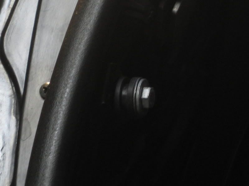

    1-Cover: OEM part number: 8E0-103-927-F
    1-Holder (bracket): OEM part number: 8E0-899-803
    1-Bolt: OEM part number: N-105-538-01
    2-Spacers: OEM part number: 078-129-734-A
    2-Grommets: OEM part number: 078-129-669
    The holder(bracket) needs to be attached (screws not included) to the underside of the main radiator support (right under the rubber seal) where the front mounting point is on the cover.
    Then the spacer/grommets attach to it and also to the longer bolt in the washer fluid container...then you can simply slide the C shaped supports over the grommets to clip in place. I trimmed about 1/2" of that little rear lip to get it to sit further rearward and line up with the grommets.
    I'll share pics tonight when I have a minute to upload them.

    Here are the photos I promised...I apologize for the delay.
    Lower bracket/bolt (re-used shorter washer fluid bolt here). Sorry I forgot to take a pic of just the bracket itself. Here you see the bolt and how the cover attaches to the grommet around the bolt. You can even see the screw I used to attach the bracket.
    Here is the new longer bolt at the washer tank with grommet/spacer in place.
    Here is pic of rear cover and the 1/4" to 1/2" I cut to make the cover sit back further.
    Finally cover attached to mounting points and in place.

    So the bolt (N-105-538-01) is shown holding up the washer fluid reservior.
    The old washer fluid reservior bolt is shown near the bumper in pic 1.
    The spacers (078-129-734-A) are the metal washer-like things on either side of the grommets (078-129-669). There is one spacer and one grommet per bolt.
    The bracket (8E0-899-803 ) mounts to the main radiator support, and the short bolt attaches to this bracket.
    The screws necessary for mounting the bracket are not included.
    EuroA4, is everything I have said correct? Correct me if I misunderstood something. If the screws weren't included for the bracket, then what did you use?
    Thanks and +rep for the pics.

    Quote Originally Posted by clemsongt View Post
    The bracket (N-105-538-01) mounts to the main radiator support, and the short bolt attaches to this bracket.
    Yes, correct on all accounts. I just used a short sheet metal screw to attach the bracket to the rad. support.

    Just did this, just so you know what I did. The right cover actually doesn't really move just when you put it in. These are the part numbers I used.
    Battery panel - 8E1-819-447-01C
    Battery insert panel - 8E1-819-422-A-01C
    RS4 Side panel - 8E0-103-927-F
    Bolt: N-105-538-01
    Grommet: 078-129-669
    x2 Spacers: 078-129-734-A
    Take this bolt out(used 10mm socket)
    In the picture I used Bolt(N-105-538-01) then Spacer(078-129-734-A) inside of Grommet(078-129-669) then another Spacer(078-129-734-A).
    After I put the new bolt in it fits pretty snug. Got everything from www.genuinevwaudiparts.com
    Haven't done anything to attach this to the vehicle, it doesn't really disturb anything or stick out from the frame, so I just left it as is.
