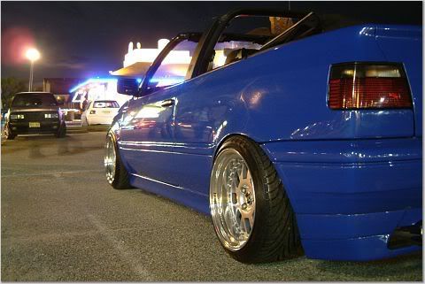

    Quote Originally Posted by Quattro View Post
    end result is the same, to help prevent rubbing or run wider tires and not rub!
    End result is the same for function, but appearance is drastically different. Here are pics of pulled fenders, you can't even notice the difference with rolled fenders visually most of the time.
    notice the body work needed to "pull" fenders not just roll

    Re: differences in "fender rolling" and "fender pulling"
    Quote Originally Posted by craymond5 View Post
    exactly what was needed - those are better pulled fenders than i've ever seen - cleannnn

    May 03 2008
    28387
    06' B7A4 20T Non-Sline
    Monterey, CA, 93940
    ^ exactly, those re pretty pulled and rolled fenders i feel...nice jobs too..

    i have done both.
    i pulled my fenders on my mk3, hammer dolley, alot of time, test fit after test fit, some filler, seam sealed and painted... to get my rs's snug.
    I roll fenders, east wood roller... i did this to my b7 and evo and to my mk3 before i pulled them. I also only charged 60 to do the front and if it were all 4 corners i would do 150 because he rears are a pain in the ass.
    You can also flare... this is where you use the roller to do just that... push the fender outwards, essentially like a pulled fender but retaining the line... i would do this for friends because its such a pain in the ass and takes a while to get it perfect and smooth.
    I miss doing bodywork :(... Now i just play with numbers
