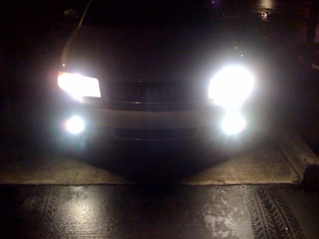

    Ok so i have a
    -2002 A4 B6 with HID lights (they came stock with the car)
    Now the problem:
    - The lights have gotten dim. and the driver side is still bright some what, as for the passenger side........ its almost as bright as my foglights. Someone said the Ballast are getting old. Is this true. Or is it the bulbs?
    The bulb size is D1s.
    Now do u guys think its the bulbs or ballasts?
    And where can i find the cheapest bulbs if i need them. I hate driving at night
    here are some pictures! (they might look bright in here but they are dim as hell. And u can see the diffrence between the right and left side)

    And yes. they are dim. Instead of them being blue when u look at them. One now has a light purple tint and the other is getting dimmmer and whiter to yellow

    Added some pictures so u guys can see the diffrence

    After a little searching, looks like early or all MY 2002s came with D2S and then was changed over to D1S bulbs either at MY 2003 or mid 2002 models.

    IIRC, early production B6's used leftover B5 D2S. MBtehBody had this problem when he ordered e-codes. i've only seen D1S replacment housings (euro or US spec).

    That would explain why. So to the OP, check your ballast and see what it lists for bulbs, D1S or D2S to make sure.

    Last night I noticed that my HID's were dim too. I was driving around town to find a clear spot to check out the lunar eclipse, and I noticed other car's with HID's would always over illuminate my lane when we passed each other. It’s a 04.

    OK guys how sure is everyone that they are D2s bulbs and not D1s. the car has been stock since the first day back in 02. No one has messed with it. I dont want to take out the headlights right now cause its raining hard in Cali and its cold.

    I had the same problem, both xenons were getting dim and purple. I also have an '02 with D1S (the D1S was written right on the headlight housing). I changed both bulbs (got them from genuinevwaudiparts.com) and the brightness came back.
    Here is a pic of the old bulb, see the white in the round part.
    Here is a pic of the new bulb, it is clear in the round part.
