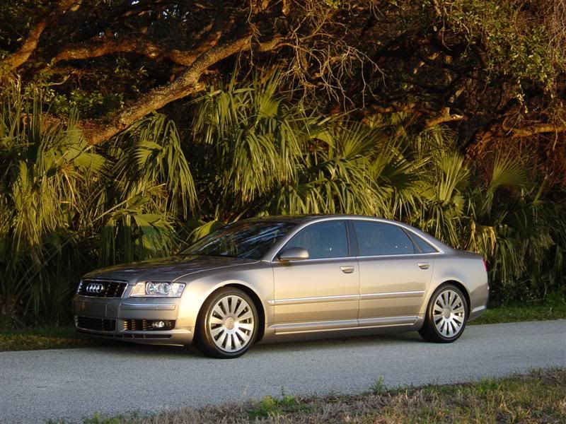

    All depends on what you're trying to accomplish. These are three of the D3's I've had - some VAG-COM Lowered and one with a module. Pics show the absolute limit of each option.
    VAG-COM:
    Module:

    Looks great, what does it mean to have it lowered via Module?

    You instal a suspension lowering module that seds a new signal the the suspension controller. Gives you the ability to lower is further than VAG-COM and to switch back an forth to the factory settings when needed (and it will be).

    Are those 20" Hartmann wheels on the lowered A8's?
