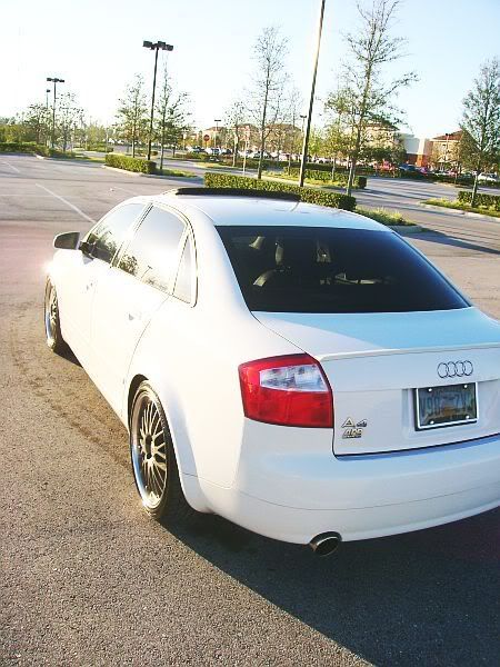

    I just went to Autozone and bought a slightly tinted license frame. It came with bolts that fir perfect. And then to make it look nice i bough bolt caps to put over the screws. The bold caps just snapped right over them and looks great to me. The pic i have isnt the best.
