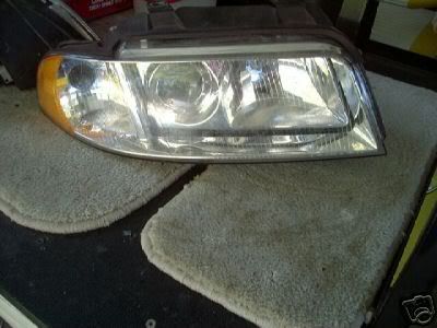

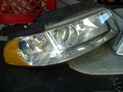

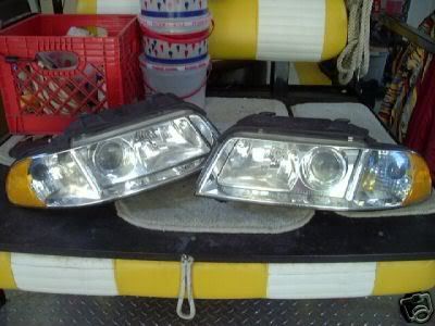

    i'm thinking about buying a pair of 99.5+ one piece headlights and the seller sent me this
    "Here is the information from the headlights and model numbers if you want to check all the information on them.
    They are Velco headlights made in Spain.
    this is all the information on each headlight
    Right- USA Right Light
    16/03/01 M D2S H7 VF2
    89301821
    8D0941 004 AR 1853681100
    3157NA DOT SAE HR A 13PP298 VOR H 7 D 29
    Left Side
    10/3/01M Light headlight
    89301811 D28 H7
    8D0941 003 AR 1853683100 VF2 Valeo
    3157 AN DOT SAE HR A 13PP298 VOR H7 D28
    it saysboth d2s and h7 so i dont know if its xenon(d2s) or halogen (h7)

    i just replaced my low-beam bulb in my b5S4; my lights are identical to yours.
    The pictures above are of halogen lights.
    Trust me, you would know if they were Xenon.
    This tells us that not ALL S4's have Xenon headlights.

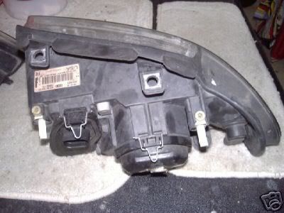

    pics of the bottom of the headlights would help a LOT

    A pic of the bottom helps. The xenon setup has a ballast slot, where as the halogens do not.

    those are hid.see the lowbeam 'case' theres the yellow triangle which indicates high voltage aka HID.
