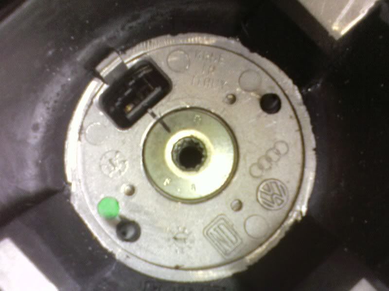

    Cant get steering wheel off! How do i get this bolt off? Pics
    hey guys, so im replacing my headlight switch and i need to remove the steering wheels. I have the airbag out and am now stuck on this. Its the main bolt thing that holds the steering wheel on. I used an allen that fit perfectly in it, with an extension and it bent the allen wrench. What do i need to do to get it out?

    i think it is a 12 or 24 point. that, along with an air gun should get it right out

    its a triple square (xzn)
    I don't remember the size..12mm I think?
    you can buy the triple square bits at an autozone if you have one(the other parts stores didnt have em around here) they are called 'metric internal wrench set" there.
    don't use an allen or torx, you'll strip it. don't use air tools either, just a breaker bar.

    IIRC a T55 torx bit fits right in there. That's what I used, it came off using an extension and a socket wrench. It's on there really tight though, need to put some elbow into it.

    I've had realllly bad luck using Torx bits where a triple square is supposed to be used. Spend a few dollars and get the right tool . How do you plan on getting it out if it were to strip?

    so it looks like everyone has used the T55 tork bit... so i guess i will go pick one of those up today

    i just picked up a t55 torx, so i'll see what happens tonight

    alright, so its fixed! Got the switch out and it had melted a bit to where the spring loaded metal piece wouldnt go back up to make the contact. I just used an exacto nife to clean it up and bam it works again
