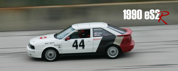

    You are looking for something like this
    This is Jimmy Pribble's eS2 he used his own totalled S6's AAN motor and built this beauty from the bottom up!
